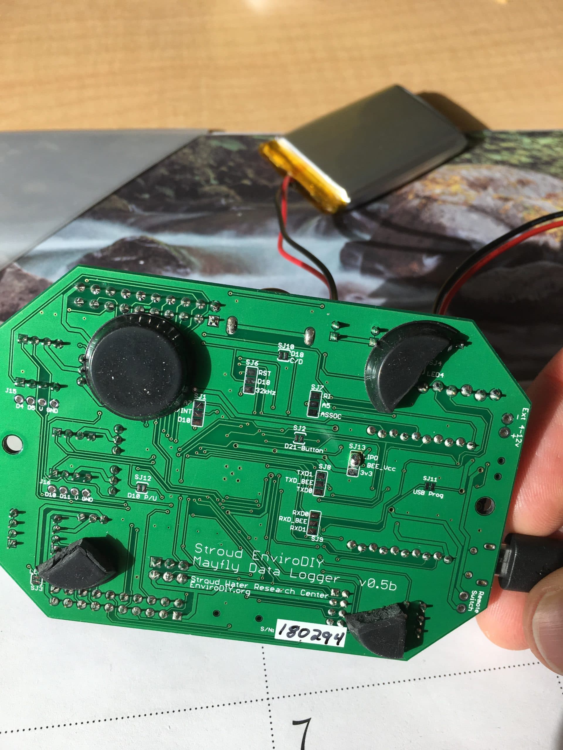

                                        I’ve cut the trace at SJ13 and made the solder bridge to directly connect the LIPO battery to the modem. Now the LTE-M XBee doesn’t reply to anything – I’m sure it’s not powering on. Am I missing some switch or setting? I’m using some version of logging_to_EnviroDIY.ino.

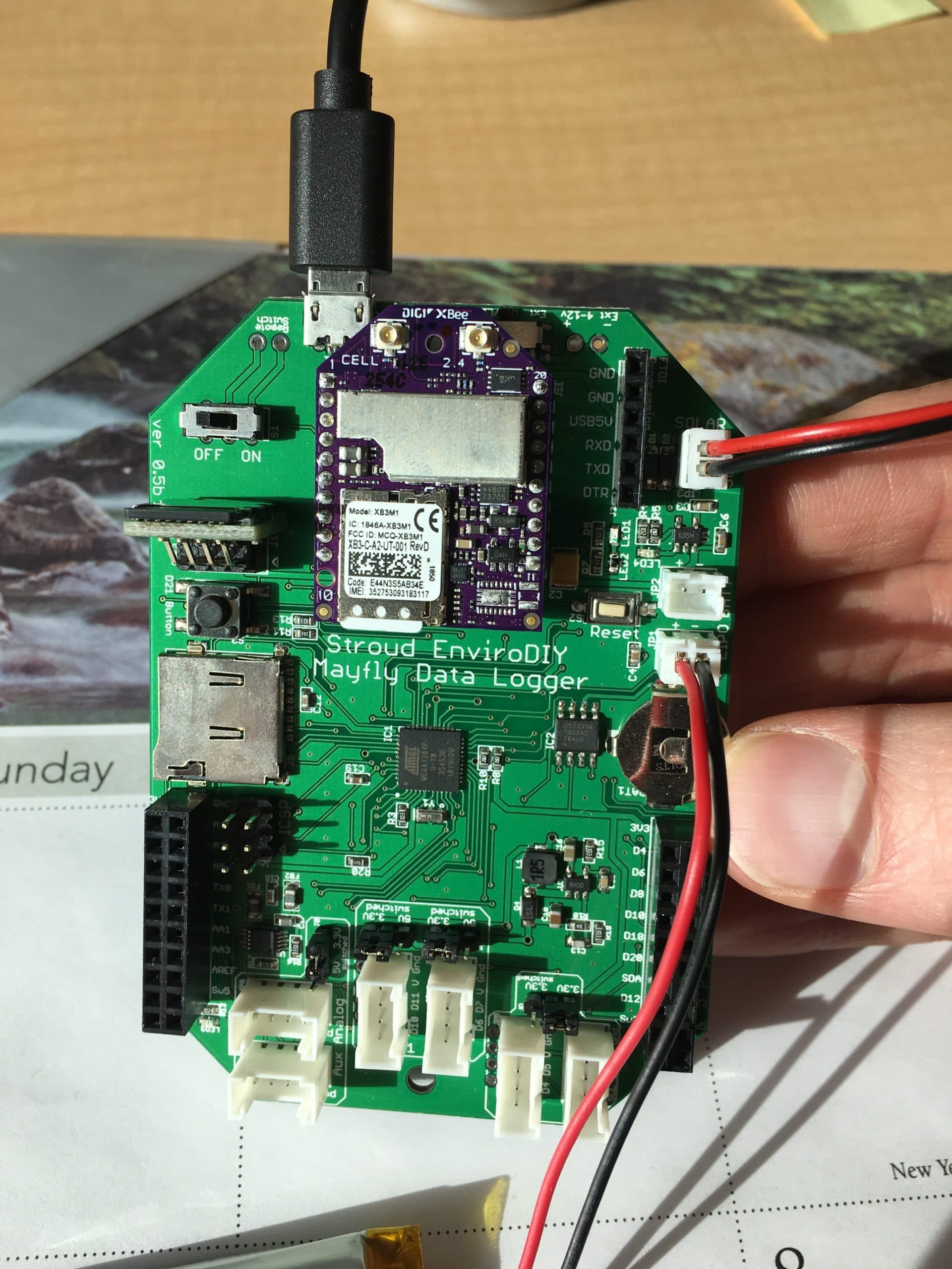

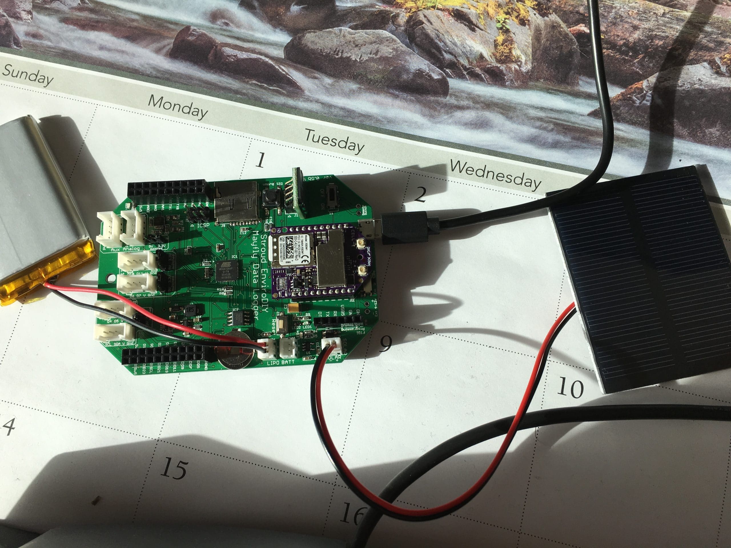

                                          • #12741
                                            BrianJastram
                                              Cal,
                                              I have the hardware:
                                              Mayfly Datalogger v0.5b
                                              Digi XBee3 Cellular Lte-M/NB-Iot – XB3-C-A2-UT-001
                                              No antenna – 3 bars of AT&T on my iphone
                                              Soldered SJ13 and cut trace BEE-Vcc to 3v3 – 4.19V between Bee pins 1 and 10
                                              3.7v Lipo battery
                                              Solar panel from mayfly startup kit
                                              USB to Windows PC – XCTU installed but not implemented
                                              Hologram SIM activated
                                              Software is:
                                              logging_to_EnviroDIY with lines 53 (loggername), 54 (file name), 58 (registration token) 59 (sampling feature), 67 (BEE_TYPE = “gprs”), 68 (APN = “hologram”), and 321 (onboard_battery multiplier * 4.7 *) customized
                                              and I’m getting this message from the Arduino 1.8.8 Serial Monitor:
                                              09:44:27.286 -> — Request —
                                              09:44:27.286 -> https://data.envirodiy.org/api/data-stream/
                                              09:44:27.333 -> TOKEN: d02f68c0-2ed7-44e4-b912-d27c5aec74b0
                                              09:44:27.379 -> Content-Type: application/json
                                              09:44:27.426 -> {“sampling_feature”: “85e1d0c8-40dd-49ad-9a3a-6619a5500a6f”, “timestamp”: “2019-01-25T10:44:27-05:00”, “fec11d32-0658-4ef0-8a27-bdffa2104e31”: 26.25, “a7329b1b-b002-4fa8-afba-ae83b82ab8e9”: 4.94}
                                              09:45:08.974 ->
                                              09:45:08.974 -> Request to data.envirodiy.org timed out, no response from server or insufficient signal to send message.
                                              I’ve tried multiple iterations of connecting the battery to the board.
                                              My hologram dashboard shows the device state is live but there is no usage.
                                              My site on Monitor My Watershed shows ‘Sensors have no data’.
                                              I have a 900Mhz radio network setup here in the Minneapolis MN and I know those radios (RF450) need individualized configurations and I haven’t done that type of thing to the XBee3 yet.
                                              I would like to get this XBee3 connected and configured and get my data logging to the https://data.envirodiy.org/api/data-stream/ server.
                                              How can I fix this?

                                                BrianJastram
                                                  mdean,
                                                  I want to try those things but don’t have enough experience yet to know exactly how. When you reference TinyGSM (increasing the timeout time) what exactly do you mean by TinyGSM? And defining the modem serial at 9600 is understandable except I don’t see where to do that (in my logging_to_EnviroDIY sketch or in a different sketch that sets up the modem)?
                                                  I feel like I’m close.
                                                  Thanks for your input.

                                                                                After a few months of successful communication with the DIGI XBee3, I am now starting to get failures with longer and successive Internet messages. Delays between sending messages helps.
                                                                                I believe the problem is power related even though I’ve made the solder jumper. Once the XBee fails to transmit, I have to power-cycle it or airplane mode on/off to get out of the lockup. I’m invested in modules and software, so I need to make this solution work this summer rather than to start over with some other modem.
                                                                                I think I should be able to solder an additional jumper wire or a capacitor from somewhere on the Mayfly to the Bee socket to increase the power supply to the XBee. Does anybody know if this would work? If so, where should I make the connections? How big of a capacitor?
                                                                                Cal
                                                                              • #12887
                                                                                Sara Damiano
                                                                                Moderator
                                                                                  There’s a known bug from Digi that any of the XBee3’s with revision “B” of the primary processor, where it will become unresponsive even with very short dips or irregularities in voltage: https://www.digi.com/resources/documentation/Digidocs/90002258/#Troubleshooting/ts_brownout.htm%3FTocPath%3DTroubleshooting%7C_____7
                                                                                  I don’t know about the capacitors though. A manually soldered capacitor chain might create more problems than it solves. https://nimbelink.com/Documentation/Skywire/1001619_Breadboard_WhitePaper.pdf
                                                                                • #12888
                                                                                  Anthony Aufdenkampe
                                                                                    Sara, thanks for your link to the bug on the XBee3 LTE-M RF Module. That is helpful to know that some of the issues folks have experienced were due to a known hardware bug. Do you know if the hardware fixed modules are available to purchase yet?
                                                                                    Also, regarding your concern about adding a manually soldered capacitor chain, your link describes why it wouldn’t be a good idea using a breadboard, or probably even the SparkFun Breakout Board for XBee Module, because the power traces are undersized to transmit those short bursts of high-amp power. However, it seems that manually soldering capacitors into an appropriately-sized power line would likely work, right?
                                                                                  • #12889
