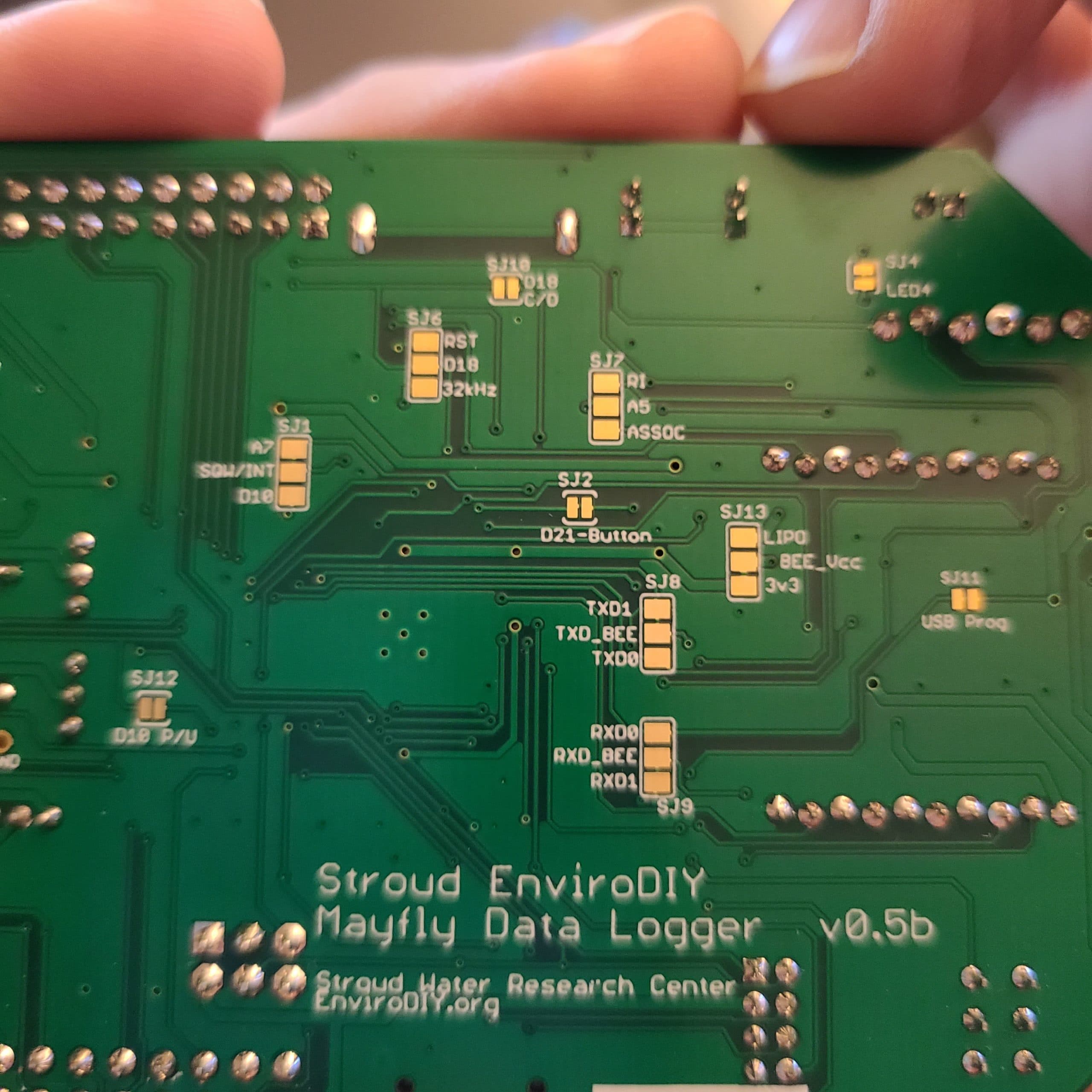

Another thing to note, the ClariVUE10 sensors require 9.6v to 18v DC to operate. The previous EnviroDIY Mayfly boards we sold prior to the fall of 2021 were not capable of powering these sensors. The Mayfly v1.0 we released in October and the new v1.1 board releasing next week are able to generate a 12v power source capable of powering the sensor, but you have to move the small jumper next to the Grove jack to change the voltage level sent to that jack to match whatever sensor you’re connecting (your options are 3.3v, 5v, and 12v). So instruction for all these steps are being finalized now, along with writing and testing new code examples for all the major configurations we recommend, which will include the ClariVUE10.

Thank you for the information. I just wanted to clarify something mentioned that may be a roadblock with installing these turbidity sensors. The boards we are using are the Mayfly Data Logger v0.5b (As indicated on the back of the board- pic attached). These will not be able to power the ClariVUE 10, as they only have a maximum voltage output of 5V? Correct?

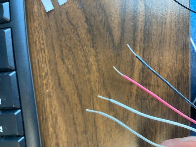

Hello, I have a few Mayfly dataloggers deployed with Campbell Scientific OBS3+ sensors. I recently purchased a Campbell Scientific ClariVUE10 sensor and a Mayfly 1.1 datalogger and am looking for some advice. I noticed that the new ClariVUE10 has only 4 wires (OBS 3+ has 6). Can I use the EnviroDIY Multipurpose 6-pin screw terminal to attach the new sensor to the board or do I need to purchase something else?
If I can use the 6-pin, which wires plug into which screw terminals? White is SDI-12 data, red is 12V power, clear is shield and black is ground.

The old Campbell OBS3 turbidity sensor was an analog-output sensor that had 2 separate voltage outputs, one 5v power supply wire, and 3 ground wires, which is why I designed the old version of the 6-pin screw terminal board that way, because we primarily used it with the OBS3 sensors and connected it to one of the Aux Analog Grove jacks on the Mayfly board.
The Campbell ClariVUE10 sensor is a digital-output sensor that uses SDI-12 protocol and only has one signal output and 2 ground wires (plus the one 12v power wire). And because we wanted a new screw terminal board that gave people the option of also combining signal pins (for hooking two SDI-12 sensors to one board) or adding resistor dividers for analog sensors, I designed the new multi-purpose screw terminal board to replace the old version and give users the option of configuring the board for different types of sensors.
In your case, you are able to use the old style screw terminal board with your Mayfly v1.1 board and a ClariVUE 10 sensor if you connect the wires as follows:
- Black wire (ground) and clear wire (shield) to any of the screw terminal board’s GND pins
- Red wire (12v power) to the screw terminal board’s VCC pin
- White wire (SDI-12 data) to the screw terminal board’s D2 pin
Then you’ll need to connect the Grove cable from the screw terminal board to either of the two Grove sockets in the center of the Mayfly (the one’s labeled D4-7 SDI-12). You’ll also want to make sure you move the little jumper block next to that one socket from the default 3v position to the 12v position. Once that is connected and the switched power (D22) is set high so that the sensor is powered, you can communicate with it through the D7 pin. The sensor ships from the factory with the default SDI-12 address of “0”, so you might want to change it to something else if you don’t want it to conflict with any other SDI-12 sensors you connect to the Mayfly at the same time. If you want to use a Hydros21 CTD sensor along with the ClariVUE10, connect the Hydros21 to the Mayfly’s other SDI-12 Grove jack and keep that one at the default 3v jumper position (we’ve found that the Hydros21 sensors work best at 3v), but you’ll have to change the Hydros21 channel number to something other than its default “0” channel, otherwise it doesn’t respond properly to measurement commands. We typically use “1” for the CTD channel and “2” for the turbidity channel. We haven’t published an example sketch of using a ClariVUE10 sensor yet because we’re finalizing our testing of various configurations with the new sensors, but I’m hoping to publish that example next week on Github.
