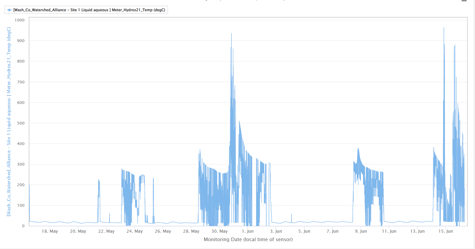

                              JK_WCCD
                                Hello,
                                We have been experiencing some issues with our mayfly readings. Attached is an image of one our previous temperature readings over the course of about a month. We are not sure why the readings periodically go haywire and then go back to normal. We are seeing the same inaccurate readings for conductivity and water depth. To give some background, the sensor got buried under a gravel bar back in early April and we had to dig it up and reattach it to the stake. We ended up having to attach the sensor upside down on the stake.
                                Could there have been some possible damage to the sensor to be causing the inaccurate readings? Are there any methods to try and fix or reset the mayfly to get accurate readings again?
                                Our site code is “Wash_Co_Watershed_Alliance – Site 1”
                                Thank you.
                              • #19154
                                  It looks to me like the CTD sensor was damaged during whatever event happened on April 5.  Unfortunately the sensors are very sensitive to physical damage so you’ll probably need to replace it with a new one.
