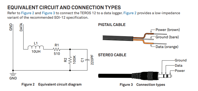

            • #18827
                I’ve attached a screenshot from Meter Group’s Teros 12 Integrator Guide.  It shows the wiring scheme for the bare-wire version and the 3.5mm stereo plug version.  If you’ve got the sensor with the 3.5mm plug, then you’ll need to compare this diagram to whatever breakout board you’re using to match the tip, ring, and sleeve to the power, ground, and data lines.
                Then you can connect those 3 lines to whichever board you’re using.  Power to Vcc (3.3v or 5v, depending on your board’s operating voltage).  Ground to Ground.  Data to a digital pin.  We usually use D7 in our example sketches because that’s the line on the Mayfly’s dedicated SDI12 Grove jack.  If you’re using a different board, you can select the pin, as long as it’s free and not used by anything else in your sketch or on-board circuitry.
