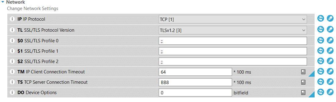

2021-07-28 at 4:10 PM #15736
In the XBee DE field, type 75B. MQTT port is 1883 (0x75B).

2021-08-02 at 3:53 PM #15761
Hey @neilh20. I just had a thought. The fact that the software works with the Digi WiFi S6B. Do you think that means its an issue with the actual cellular connection as opposed to the code?
2021-08-02 at 4:13 PM #15762
hello @zeke-holloman. Just looking through it, and yes thats my assumption at the moment is that its the cellular side that is not connecting.

2021-08-02 at 6:33 PM #15766
@zeke-holloman, I figured out that the other day I hadn’t changed the apn to the source I was using.
So with your code, my apn and thingspeak API, using tera-term 4.105 with TimeStamp and the following changes I got a good response from thingspeak

@neilh20 I tried running the code with your ModularSensors library, and it still didn’t work. The apn I’m using is hologram. If I am using a Hologram SIM card, is that correct, or should I change the source to something else? Also, what is Tera-term with Timestamp, and is that something I should consider using?And also, one more question. Is ThingSpeak with API different that ThingSpeak with MQTT? Right now, it looks like I’m using the MQTT connection.
2021-08-03 at 11:28 AM #15770
Everything I was talking about is MQTT with Thingspeak. I tested it on my Thingspeak connection I created. It was just allowing the micro-python code in the Xbee to handle all the network and MQTT items vice using the AT commands from the MayFly to the Xbee as it looks like is happening in the enviroDIY libraries.

2021-08-05 at 10:40 PM #15816
@zeke-holloman I’ve been out the office. Just to summarize our offline investigation – I got a good POST using your thingspeak settings. It seem to me that its your modem data plan that isn’t connecting in some way. Maybe there is a better error indication from DigiXBeeCellularTransparent, but its an evolving area to make it easy.
2021-08-06 at 11:57 AM #15818

2021-09-14 at 9:56 AM #15899
@neilh20. Hey Neil! Sorry it’s been a while, but just a quick update. I was able to get it to work. I ended up purchasing a new XBee cellular modem (same type) alongside the Digi IoT Development Kit. Works great now!
I’m thinking the issue was either that I had set up the modem with a board that wasn’t the dedicated XCTU board (I was using the Xbee Grove Development board). Either that, or I just messed up the set-up with the Xbee from the get-go.
Thanks for all your help!
