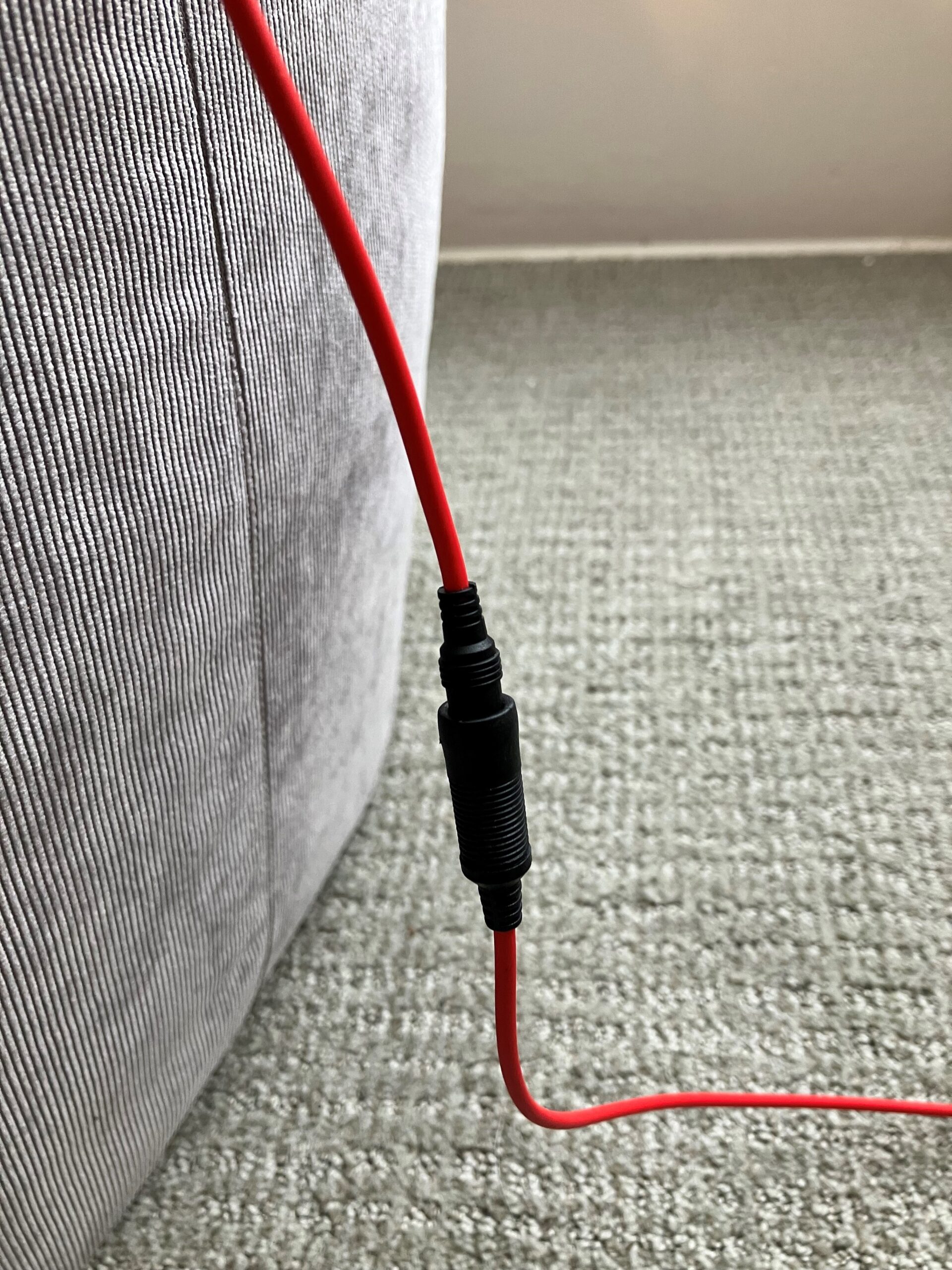

                Jake Lemon
                  Thanks Shannon. I was actually talking about the stereo jack. See attached image.
                  Since we transitioned to the new panels it has been very difficult to get the stereo jack from the panel plugged into that adapter cable. Any recommendations on that are welcome.
                • #18266
                  Jake Lemon
                    Hi Shannon. So I just received a few more panels. The stereo jack cables are going in relatively easily with these. I think I received some damaged hardware, causing the stereo jack cable to be very difficult to get plugged in. And causing a bad connection to the logger.
