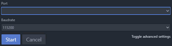

        Hi there! I recently purchased some Mayfly v1.0’s and was working to get them set up. I’m using Atom, alongside PlatformIO.
        I’m trying to get some basic Hello world code running on the Mayfly, but I’m having some issues connecting to them, specifically connecting to the serial ports. The –port selection is blank, and highlighted blue (Pictures below). Also, in the upload port of Atom, the COM port doesn’t come it.
        I went into my device manager to see if I saw any issues there, and I found a device in Other Devices (EnviroDIY Mayfly USB to UART Controller) that looks like it needs some drivers. I thought maybe I needed to download the D2XX and VCP drivers discussed other places in the forum. I tried installing those into the controller and it didn’t work.
