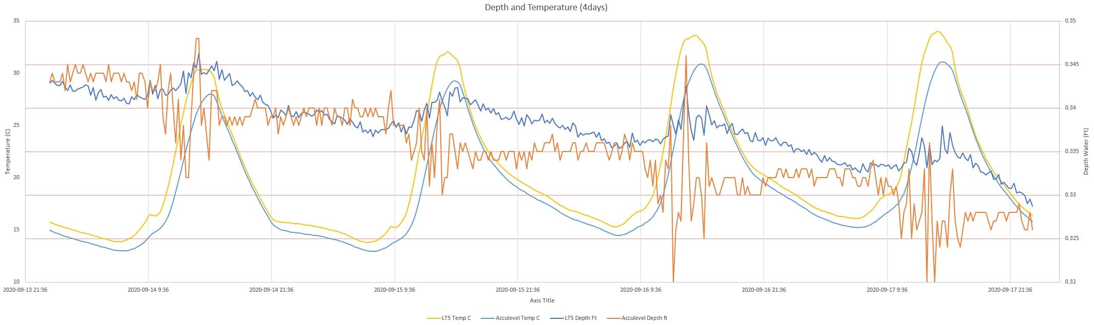

One of the ways I test the software with specific configuration of sensors and features is to run them in a simulated low water stream – a jar of water, depth change is only evaporation, so a defined depth however the temperature varies by about 15C.
Part of the dataset I’ve made into a graph that shows the way that the Insitu LT500/SDI-12 and the Keller Acculevel/RS485 respond to a 15C diurnal temperature change in the water . The dataset was downloaded from MMW (all data delivered with the reliable data delivery feature)
The full data set (messy) https://monitormywatershed.org/sites/tu_rc_test06/
