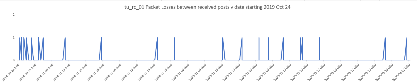

                                I have implemented a Sequence number (EnviroDIY_Mayfly_SampleNum) which increments on the Mayfly side, and then on the monitorMyWatershed it can be viewed, and any missing numbers detected.
                                So for a field system the sequence number appears to be continuous from Oct/24/2019, https://monitormywatershed.org/tsa/?sitecode=TU-RC-01&variablecode=EnviroDIY_Mayfly_SampleNum&view=visualization&plot=true
                                So for this system, running over I think an ATT CAT-M1 modem, there are only occasional packet losses of 1 – see graph generated from .xls file
                                Packet losses
                                That said I have been seeing a lot of (504) from my desk workstations – and haven’t dug into why.

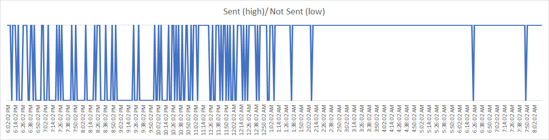

                                          I ran another test overnight, again using a 2 minute sampling interval, with no code changes, but I removed the build flags for modem debugging from the platformio.ini. Here are the results:
                                          • 427 total samples taken
                                          • 52 sample events received a Response Code 504.
                                          • 246 sample events received a Response Code 201.
                                          • 155 of the samples are absent from the MMW database.
                                          The new wrinkle here is that sometimes the Mayfly apparently didn’t attempt to send to MMW; this happened 129 times. In the log file, one of these occurrences looks like this:
                                          … whereas a “normal” interval across consecutive samples, where the Mayfly does attempt to send, looks like this:
                                          Any idea why the Mayfly didn’t send data at these times?
                                          I’ll attach the log file and a time-series chart of when data was sent/not sent.
                                          Thanks,
                                          Matt
