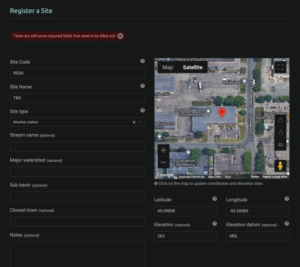

            • #17999
              nick
                @neilh20 I attached a screenshot of what I am entering to register a site. Am I missing something that is causing me this error?
                I’m wondering if the account itself is the problem?
              • #18001
                neilh20
                  @nick – I tried https://monitormywatershed.org/sites/TWItest/  and it doesn’t exist
                  What is valuable for your “error report” is the error that is occurring when you submit to MMW. That would be the screen shot you need.
                  Perhaps there is some field that needs to be filled in that is missing
                  I usually use a naming convention, as it has to be unique among all the sites, and I’m likely to be entering a number of sites
                  so could be nick_test_twi01  or
                  <organization or unique identifier><stream or function><local code>
                  So I go to https://monitormywatershed.org/ and check that I’m logged in – top right
                  Click “My Sites” – top left, then “register A New Site”
                  So I’m trying  “nh_test_twi01”
                  enter details, select map and then under Notes “Test site to be deleted”
                  then enter ~ and its created it for me
                  https://monitormywatershed.org/sites/nh_test_twii01/
