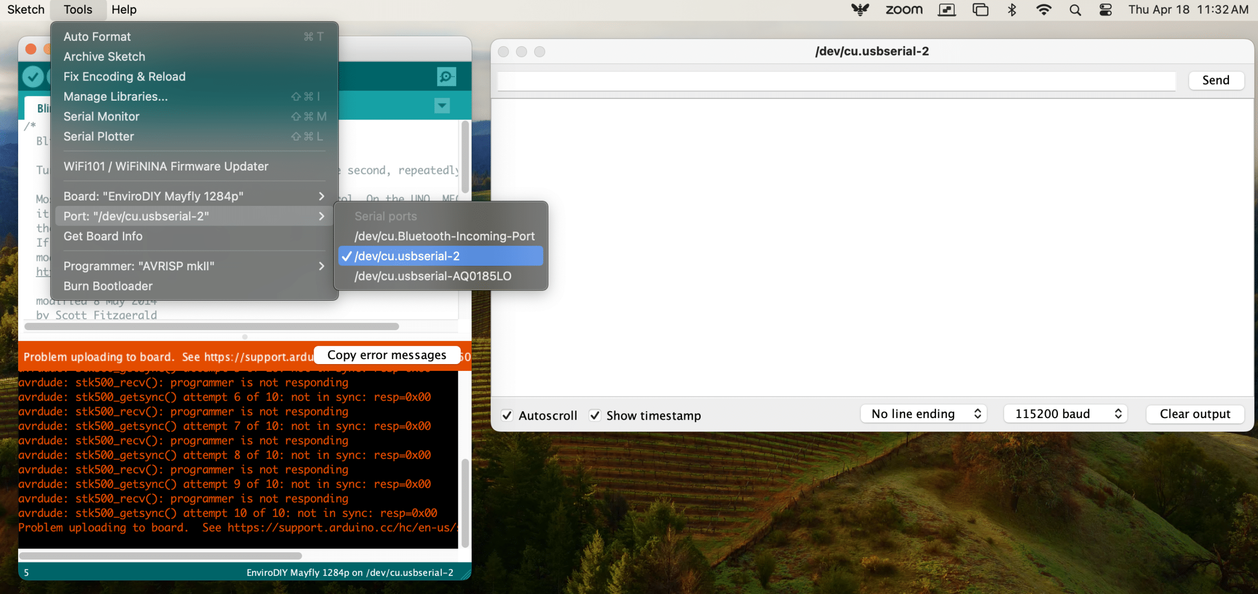

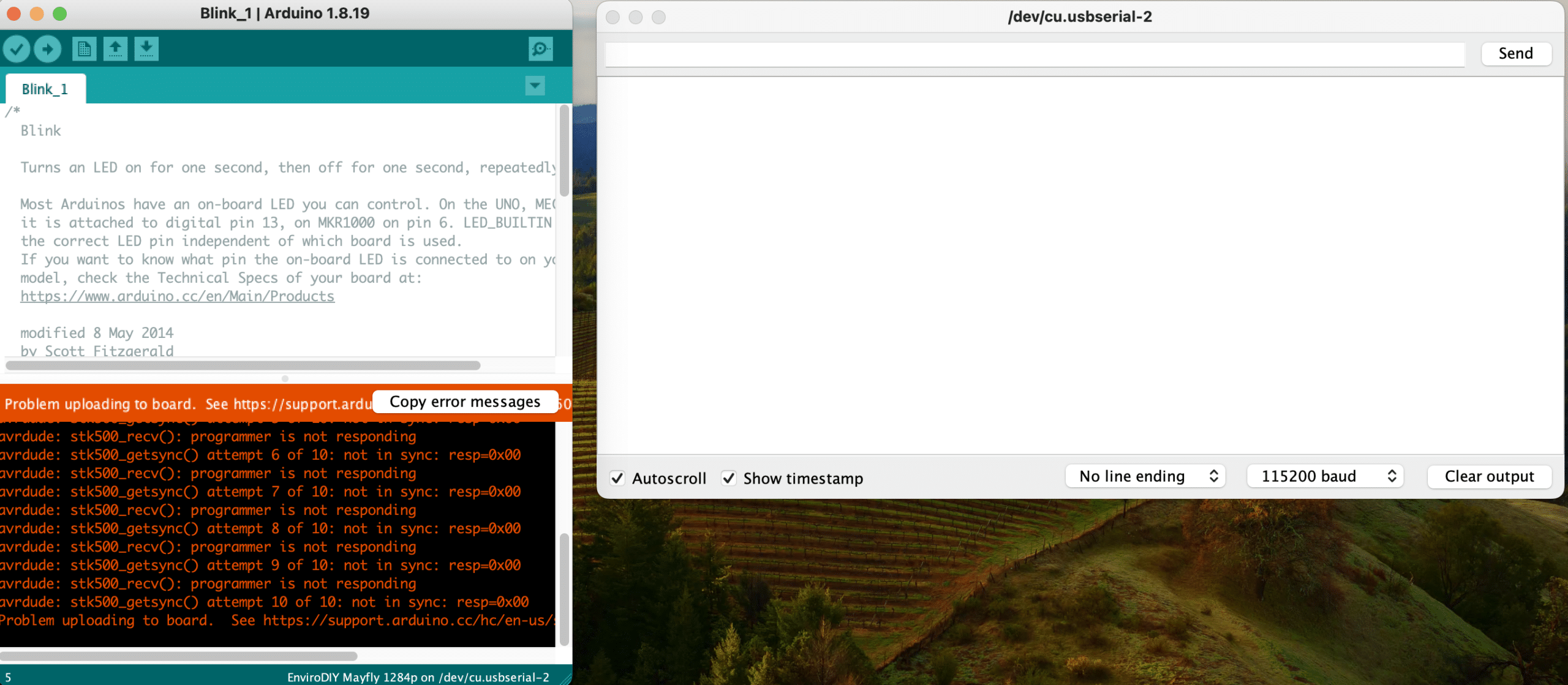

        Hello, I have been trying to connect to a board to get a sketch loaded on but the Arduino IDE is not communicating with the board. The errors I have received are:
        • avrdude: stk500_recv(): programmer is not responding
          avrdude: stk500_getsync() attempt 1 of 10: not in sync: resp=0x00
        I have followed this thread to try and trouble shoot the issue: https://www.envirodiy.org/topic/pc-and-mac-unable-to-communicate-with-mayfly-ver-0-5b/
        Things I have tried:
        • update the drivers
        • test different cables
        • test different computers
        • test in a Windows VM

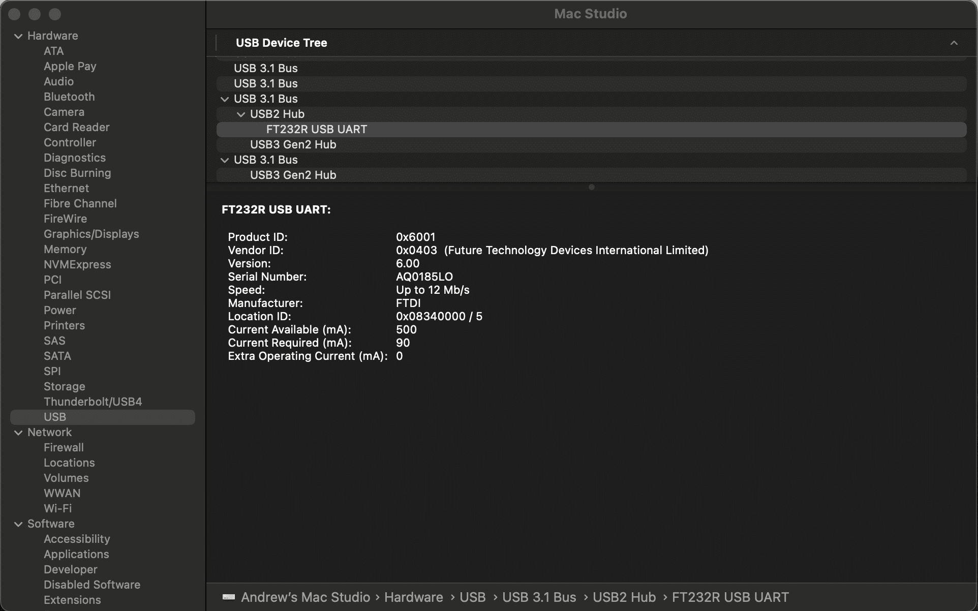

        I can confirm that my mac is recognizing the board (see screenshots)
