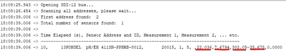

        I’m using the SDI12 library with an arduino nano. I’ve got 3 SDI-12 Ponsel water quality sensors I’m trying to get working.
        One of the issues I have is being able to separate the values into ‘chunks’.
        e.g. In the attached screenshot, ideally I’d have:
        temperature = 22.036
        ph = 7.6794
        redox = 302.05
        ph_mV = -35.678

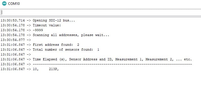

          d_bozza123
            Hi Shannon,
            So the screenshot in my first post is using the ‘simple_data_logger’ code with one SDI12 sensor attached (I haven’t connected all 3 just yet), and it seems to work quite well.
            The screenshot in this post is when I’m using the ‘simple_parsing’ code with no modifications.
            The arduino just freezes after “213P,” and doesn’t write anything else to the serial monitor.
            I had a search through the SDI12 library documentation but I wasn’t sure what the timeout value of -9999 means exactly?
            The reason why I need to separate the sensor values is because I need to only send certain values over LoRaWAN…
